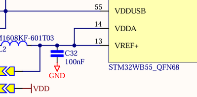

> Power supply from Nucleo board directly connected to PC3 is 2.2 V. But ADC_SingleConversion_TriggerSW_IT showing 3.298 V!
Huh? The VDD voltage on that board is 3.3 V. A reading of 3.298 V is consistent with that.
You can't use VREFBUF as the voltage to the VREF+ pin is provided externally.

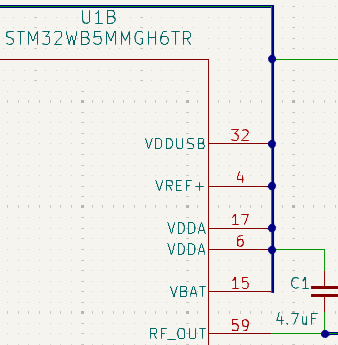

If yes, what will be the best way to do it? This is my custom PCB.
But ADC_SingleConversion_TriggerSW_IT showing 3.298 V when board is powered from batteries 2.2v ?
2025-05-06 11:07 AM
If VREF+ is different than 3.3 V as it is on the board in the example, you need to change the VREF #define.
You can also estimate VREF+ by measuring the internal VREFINT channel and back-calculating what VREF+ is.
2025-05-06 9:33 PM - edited 2025-05-06 9:37 PM
Thank you, how to measure the internal VREFINT channel and back-calculate what VREF+ ?
The battery voltage is changing - so is VREF #define. The goal is to measure battery voltage!
