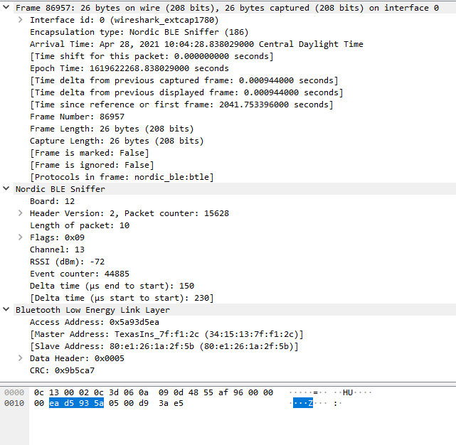

I am using an STM32WB55CG in a slightly challenging environment. aci_gatt_update_char_value() works great most of the time and returns BLE_STATUS_SUCCESS and transmits data. Occasionally the STM32WB55CG will disconnect and then reconnect. Our application continues to call aci_gatt_update_char_value() which still will return BLE_STATUS_SUCCESS but no data is transmitted. If our unit disconnects and reconnects again, the STM32WB55CG will once again start transmitting data.
If aci_gatt_update_char_value() returns BLE_STATUS_SUCCESS is there some other way for us to know if the transmission was successful?
When we are in this mode, this is the only packet that the STM32WB55CG sends.
