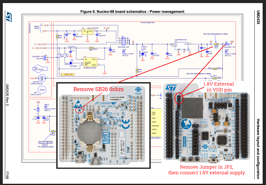

Finally, I was able to convert the board to have 1.8V in GPIOs.
The idea is based on the user manual's Power management instruction, wherein to take in external 1.8V supply and bypass the PM components related to USB voltage input.

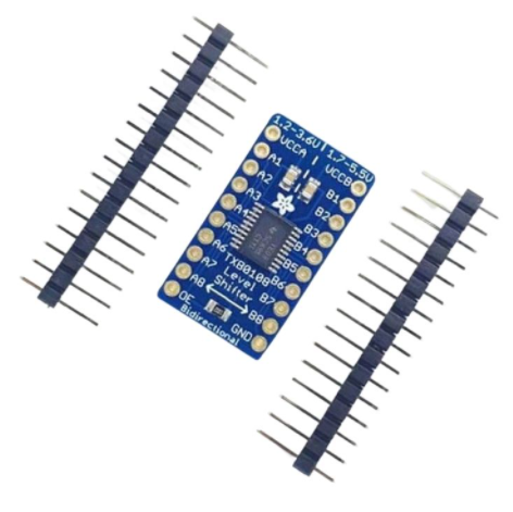

2022-03-15 12:11 PM
For the level shifter, is this viable? TXB0108?

2022-03-15 9:53 PM
