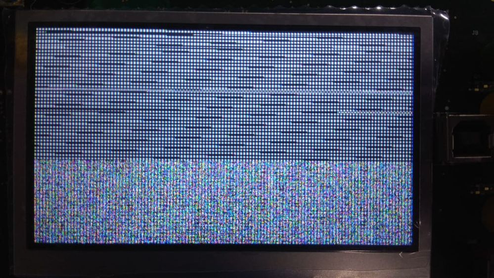

I am working on STM32F746 based custom board which is integrated with LCD and a ADV7180 video decoder IC.
I Configured the ADV7180 to run in the free run mode. Getting the Camera data using DCMI to a specified buffer.
I am trying to Convert the YCbCr 4:2:2 data to the RBG data. I am getting the Line Events. .
From the Live events I am executing the below piece of code to convert it to the RGB and then load the it to the LCD using ARGB888.

}I have initialised the LCD with LCD_FRAME_BUFFER and I am using single layer only.
I am converting the data and copying it to the LCD_FRAME_BUFFER using an intermediate LCD_FRAME_BUFFER_LAYER1 buffer.
DCMI --> CAMERA_FRAME_BUFFER --> CONVERSION --> LCD_FRAME_BUFFER_LAYER1 --> DMA -> LCD_FRAME_BUFFER
But, I am not getting the free run mode screen as BLUE Screen.
Can body point me where I am going wrong.
