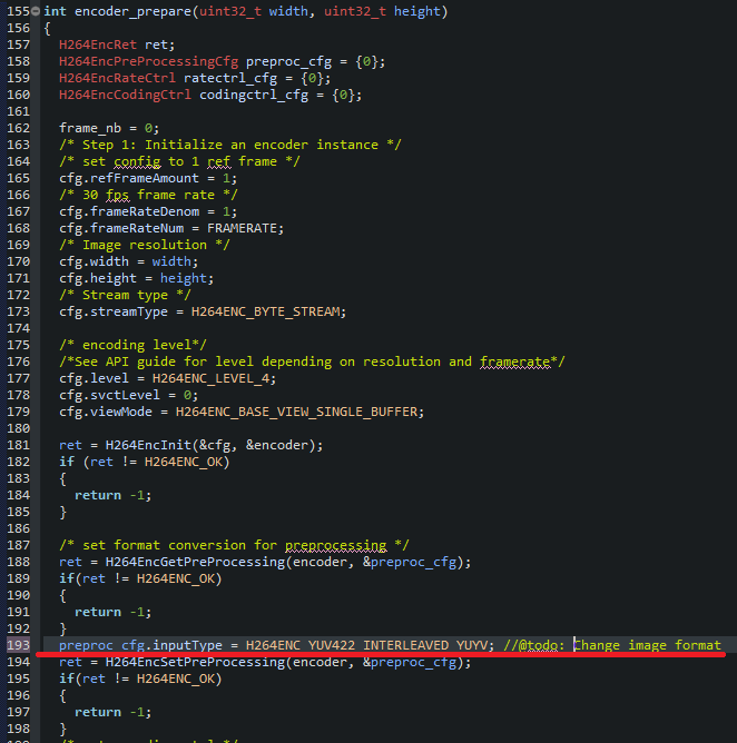

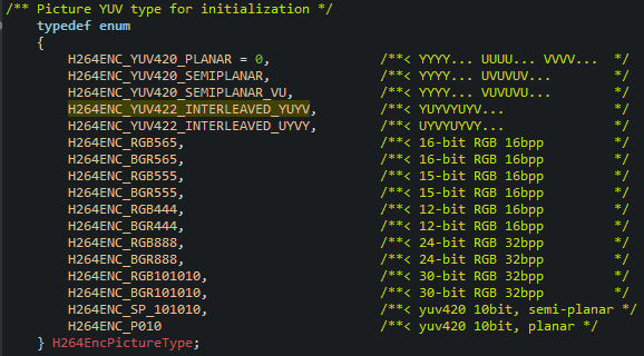

1. The VENC input format can be adjusted in the `encoder_prepare()` function:
Options of input types:
This would be based on your camera output of course. For debugging perhaps extract the preprocessed frame memory and view to verify it matches the expected encoder format.

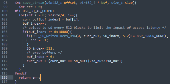

3. The VENC_SDCard example uses the `save_stream()` function to save the data to the SDCard. You could do something similar and send over SPI here instead.
