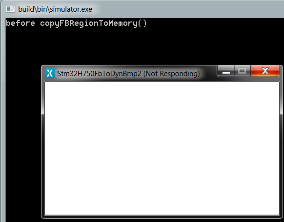

I have tried both methods and both appear to crash the simulator. I setup a very simple project for the STM32H750-Discovery board. All it has on it is one screen with a black box.
I placed the following code in the screen's setupScreen() method:
void Screen1View::setupScreen()
Screen1ViewBase::setupScreen();
touchgfx::Rect r(0, 0, 10, 10);
uint16_t* adr;
touchgfx_printf("before copyFBRegionToMemory()\n");
adr = HAL::getInstance()->copyFBRegionToMemory(r);
touchgfx_printf("after copyFBRegionToMemory() adr: %0x\n", adr);
The console output never prints before "copyFBRegionToMemory()" but appears to crash because the simulator screen remains white and the console window never prints "after copyFBRegionToMemory()".
Am I doing something wrong?
2019-08-27 12:48 AM
Hi, you can't actually use the method directly like that in the simulator because it bypasses the check for whether or not the DMA has the capability (Simulator uses NoDMA), and still tries to add blitops to the DMA queue, so it's basically just busy waiting when you call that method. You should be able to see the effects on target, though.
