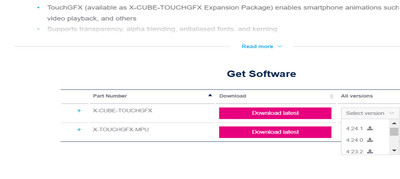

Thanks for the reply. The current MPU addon is looking for TouchGFX v4.24.0. That version isn't available for download anymore. Only v4.24.1 and v4.24.1.
Is there a place where i can get 4.24.0 so the MPU addon will align with it
2025-03-06 5:26 AM
Hi ,
Please go at this page : https://www.st.com/en/embedded-software/x-cube-touchgfx.html
and select the version 4.24.0, you should be able to download it.
