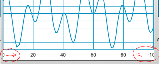

How to shift X labels min/max ('0' and '100') to be fully visible ?

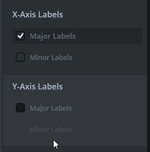

Instead you can just increase the margin of the graph area so that the labels are not hidden :
Then you can hide the y labels like so :

"I don't think there is method to shift the minimal and maximal labels."
Hm, unfortunate. I hoped labels could be accessed with getNextSibling () or similar.
"it would not make sense to shift the labels because then they would not be aligned"
I know, it seems a bit odd at first, but it's been like that for decades, and it seems users understand.
"Instead you can just increase the margin ..."
Thank you for this. I tried but every pixel is very presious on 320x240 display.

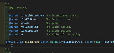

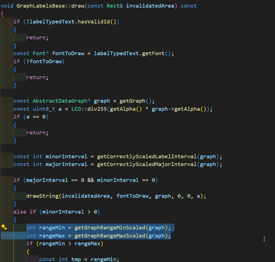

Hello @ferro ,
We did not implement that function.
However, you can create a class that inherit from graph to be able to make your own custom graph and modify the functions there.
For your specific case, it seems that the range is exactly [0; 100] so if you modify the min and max value of the index only when drawing the labels, then it won't draw the outside labels maybes :
Then you can draw them again with drawString perhaps :
This would work if you already know that you will have a static 0:100 graph, but then you could also simply not draw the label and add them manually on Designer.
You could make a custom graph where the outside labels are shifted I assume but I do not really know where to start.
