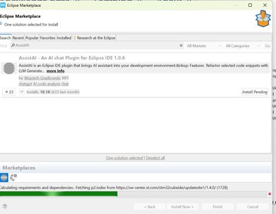

Has anyone had any success getting this to install into STM32CubeIDE?
I get the following error
Cannot complete the install because one or more required items could not be found. Software being installed: Assist AI 1.0.6.202509261754 (com.github.gradusnikov.eclipse.assistai.feature.group 1.0.6.202509261754) Missing requirement: Assist AI 1.0.6.202509261754 (com.github.gradusnikov.eclipse.plugin.assistai.main 1.0.6.202509261754) requires 'osgi.bundle; org.apache.commons.lang3 3.17.0' but it could not be found Cannot satisfy dependency: From: Assist AI 1.0.6.202509261754 (com.github.gradusnikov.eclipse.assistai.feature.group 1.0.6.202509261754) To: org.eclipse.equinox.p2.iu; com.github.gradusnikov.eclipse.plugin.assistai.main [1.0.6.202509261754,1.0.6.202509261754]I've tried finding the offending org.apache.commons.lang3 (found at maven.apapche.org) and dropping in to my plugins folder but after stopping and restarting CubeIDE the plugin is not listed in the About-Installation Details-Plug-ins.

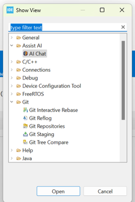

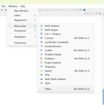

Then select Window -->show view-->other -->Ai chat
And the Ai chat will be opened

Thanks for replying. This is the same approach as I did to get the error. I've just now tried again on a fresh install of Windows 11 and a new install of CubeIDE. During the install pending I get an error and it states it's looking for a solution.
It doesn't find one so rather than giving me the license agreement I get the error dialog.
