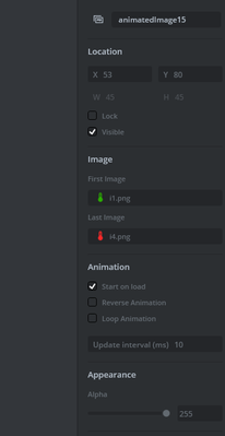

2023-11-07 3:47 AM
Have I found another bug?
Cant create animated images. It says I have duplicate name images. But I dont.

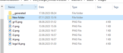

Source folder:
It is not even possible to have two same name images in same directory.
