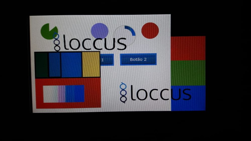

Hello i'm porting TouchGFX to a custom board using STM32F429 and a custom 800x480 16bit display.
I'm having trouble when I try to add a .png image on the TouchGFX designer. For some reason, if the .png file have any gradient effect, the resulting image will not display correctly on the physical display.
Here are some examples:

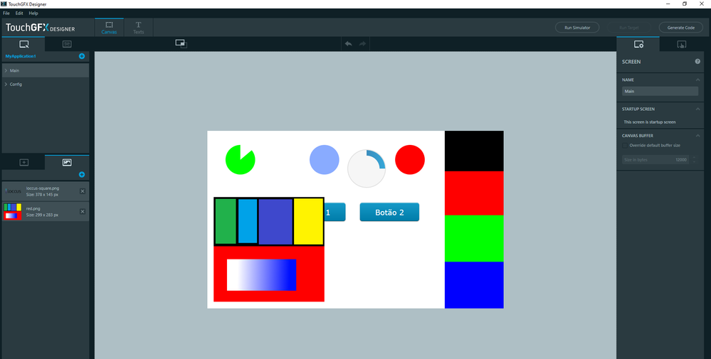

This is the example application i'm trying to show on the display.

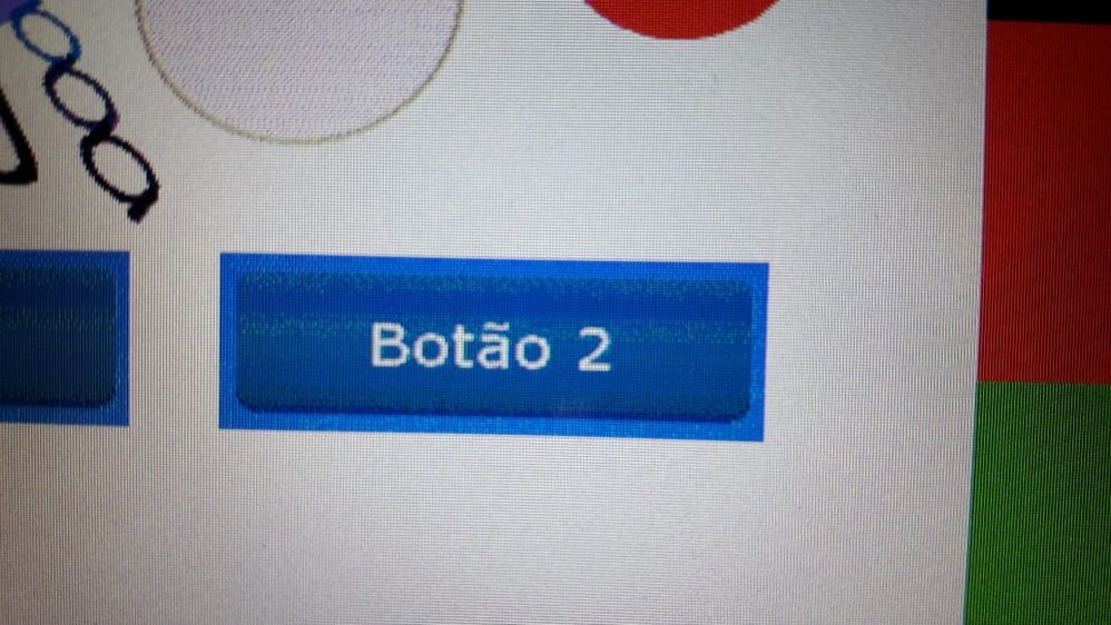

This is how the colors are displayed on the physical display:
Notice how the gradients effects are displayed on the display.
My TouchGFX project is using the follow dithering configurations:

2019-09-06 2:34 AM
I don't think anything in your configuration stands out. Could it be your RGB connections to the display? Do you actually have 8 linesfor each color?

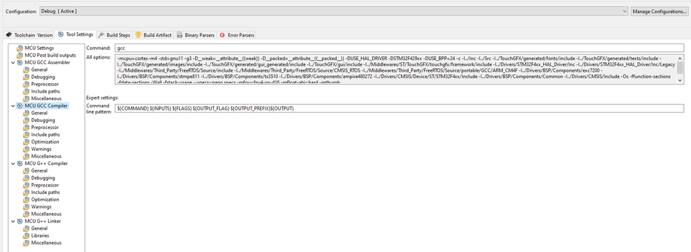

2019-08-29 8:31 AM
Hello @Martin KJELDSEN , I've changed to an 24bpp display but i'm still not representing gradients well.
I'm not sure if I'm using the right configurations for my application. I'm using STM32Cube IDE.

2019-09-06 6:13 AM
Hi Martin, you nailed it. Yesterday I revised the LCD GPIO configurations and turns out some pins were wrongly assigned. I fixed and the display is working properly with the gradients now. This was very tricky because since solid RGB colors were fine and we got confused thinking that the display didn't support RGB888 colors.
