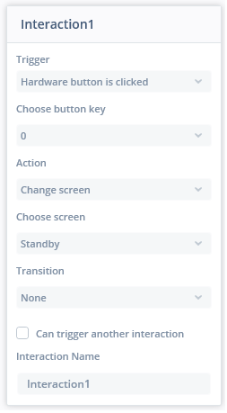

If you create a screen via designer, the goto()-function is not automatically created.
To create the goto()-function for your "Service" screen in FrontendApplicationBase you need to
implement an interaction via designer where a screen change is triggered.
You could do something like this:

for some reason, even if the view has been created with a name "service" the application().gotoserviceScreenNoTransition(); doesn't work as the code is not correctly generated in the FrontendApplicationBase
2025-06-27 4:10 AM

Ah, it makes sense. I thought it would automatically generate it based on the view you created
Thanks
