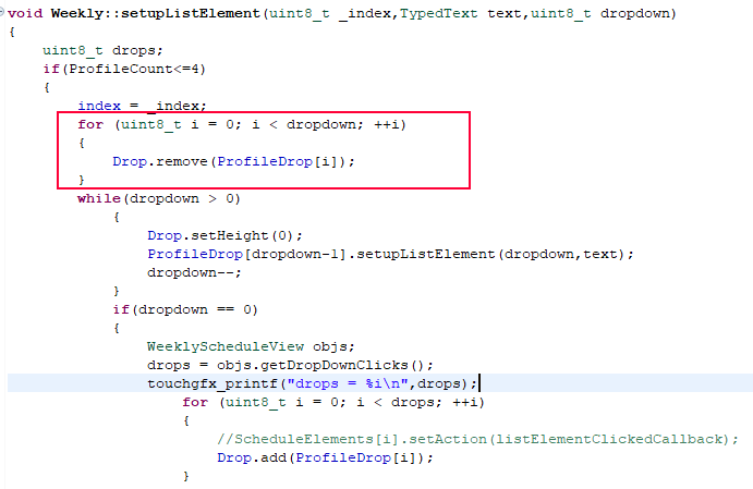

I've created a list and need to get value from model.hpp and using
WeeklyScheduleView objs;
drops = objs.getDropDownClicks();
to get value. But when it calls it crashes.

When I debug it crashes at this point but when I do not call another object it works fine.

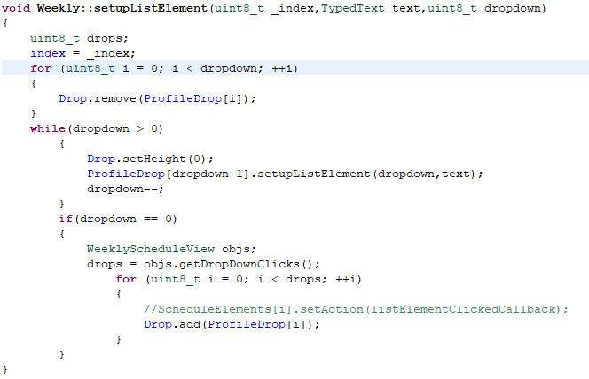

i've tried to comment this function and still crashes:

It crashes at Drop.remove(ProfileDrop[i]) or drops = objs.getDropDownClicks() ?
Also, what is your Drop object?
/Osman
2023-04-20 2:22 AM
At drops = objs.getDropDownClicks(). It always crashes when I try to call function in other class.
Do you mean Drop? Drop is a list. The only way calls other function in other class works when container is included in view window
