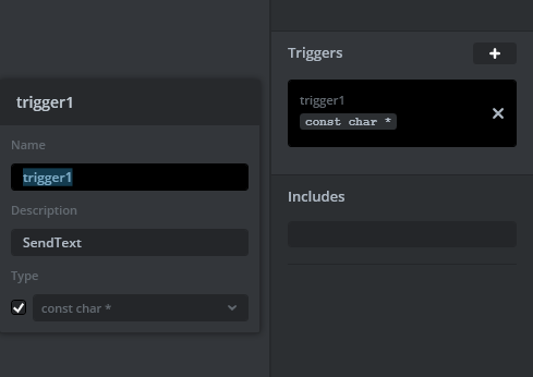

Okay, I found that here is created custom trigger:
But how that text is passed to other container does not find

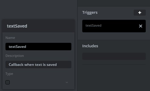

Otherway is to create Trigger and set type char * or const char * (depending what you are sending)

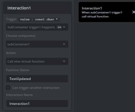

Please also note that you can use TGFX Designer Interactions to create handler for these trigger callbacks and then call some virtual function in the container:
And then define the virtual function and handle the text or trigger another callback to send it to the wiew- class.

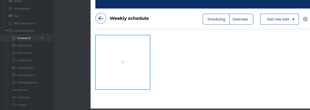

I need pass just a variable from container to view. In custom container I have button and I need to pass how many times button was pressed. Problem is this that I create in view screen list layout and in that list putting custom container

It's difficult to explain :D amm, that container is not included in my view window and I can't access it. If I add custom container in my view it would be easy but now I've created list layout and in that list is custom container .
Like this:
