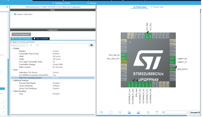

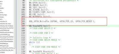

Hi,Andrew Neil,This screenshot shows my TouchGFX configuration. Sigh, I really don't know how to solve this. I removed my display initialization function and instead tried to turn on the LED before initializing TouchGFX — unfortunately, it still doesn't work. In a project without TouchGFX, the LED lights up just fine.
