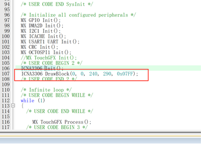

My ICNA3306_DrawBlock data transfer did not use DMA.

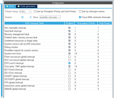

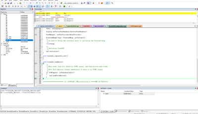

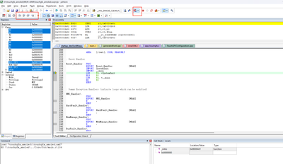

Hi GaetanGodart, thanks for your reply. I am able to flash the chip using Keil. The problem is that the program doesn't run automatically after flashing. I need to start a debug session ('Start/Stop Debug Session') and click 'Step' or 'Step Out' to get it running. I've observed that after stepping out several times, the ICNA3306_Init function is called, but then the execution gets permanently stuck right here:
if (OSWrappers::isVSyncAvailable())
hal.backPorchExited();

@weixun wrote:I am able to flash the chip using Keil. The problem is that the program doesn't run automatically after flashing.
I think you have to configure that?
Maybe in the Debug settings - configure it to do a download at the start of a session?
Have you got it to work with a simple "Blinky" project?

I have already uploaded the code to https://github.com/weixuna/touchgfx_amoled_
2025-04-14 7:16 AM
I don't think it's a Keil issue, because I can flash other programs normally. It's only when I configure TouchGFX in CubeMX that it doesn't work, so it's likely a problem with my code.

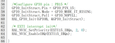

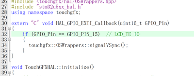

You say your program gets stuck and you show a screen shot where the current line is the end of the taskEntry. I have trouble understanding that picture, if you end up on the last line of that function that is just the closing bracket, are you really stuck on this line? There is nothing to get stuck to there.
If you mean that you permanently loop through it (through the if statement), then perhaps you implemented your hal.BackPorchExited() wrongly, you can look at a TBS we made that has a similar configuration as your (same communication, same display type, so RTOS) to see how we implemented it.
