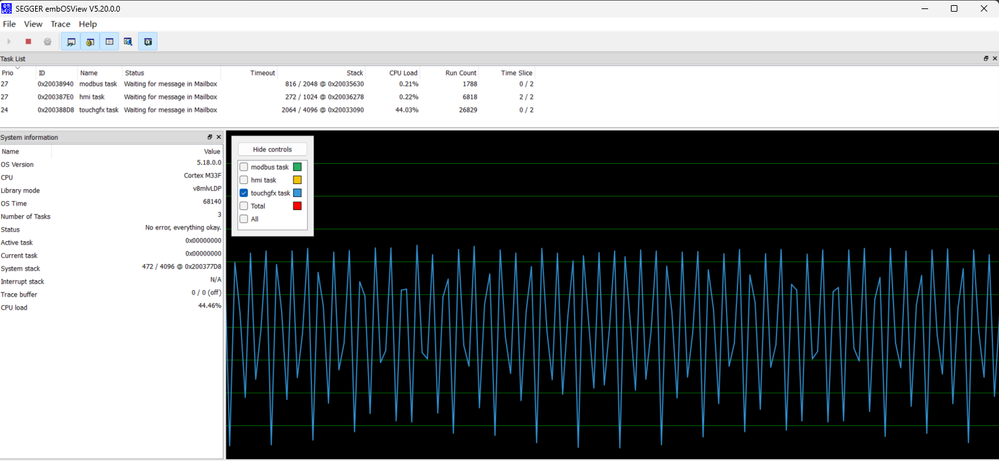

Hello, @GaetanGodart:
Thank you for your reply, by optimising the invalid operation it does work. Another problem is that I am using STM32U5 chip and when I enable the DMA2D function, the CPU load doesn't decrease, even some slight increase amount.
Regards.
2025-02-07 1:29 AM
Hello @Nex-Leo ,
I am glad it helped you!
Are you using TouchGFX? By default, DMA2D is enable, can you quickly run me through how you enable or disable it? I do not see why enabling DMA2D would increase CPU load, are you sure of your measurements? Does it happens on different UIs?
Regards,
