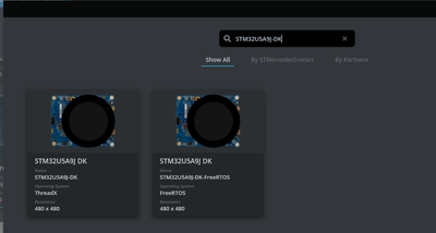

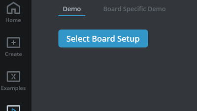

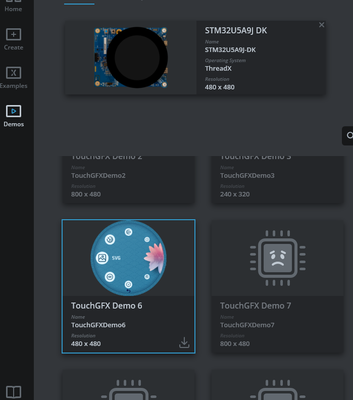

2025-02-05 8:53 AM - edited 2025-02-05 8:54 AM
Did you select first the board STM32U5A9J-DK in the Board setup before creating the demo?
2025-02-06 8:14 AM
It works,thank you!
