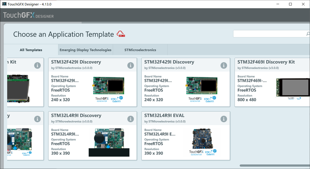

The 2x 429-disco does look strange, but it's not an issue i'm seeing here. I'm noticing you don't have a proper connection (red cloud) to the package server. Can you check your connection and try again?

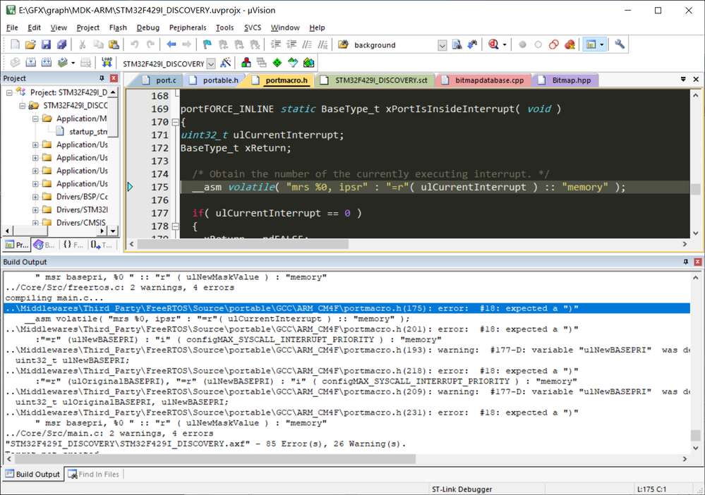

The compilation errors are from FreeRTOS code - You may be using a compiler that is not supported by some version of FreeRTOS. Which ARM compiler did you select?

Hi Martin
I didn't make any updates.I know you have updates in the application template.
There is no cubemx flag to begin with.Since there has been a cubemx flag and this has been the case ever since.
I can easily download any UI template using PC,but can not download any UI template using application template.
If I download wrong, there may be an occasional display of these.
