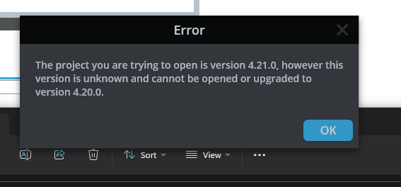

I tried setting up a project, using a Touchgfx example on a STM32F429 Eval board. Then starting a new project with an STM32F49IGT and then importing the 'Eval' project. After setting up all pins and functions again, I tried opening TouchGFX but it comes up with:
I've tried a couple of times, but get the same error.

2023-01-07 2:07 PM
Seems you misunderstand ... STM dont have standart boards ... only demo for learning.
Normal proces for custom board have many steps.
And your error window say you what is problem. Mixing more version on your PC.
Simply is impossible help you .
Install latest designer and if you have more version open project files with right mouse click...
2023-01-07 2:31 PM
Hi. Thanks for your response again. STM32CubeMx is version 6.7 and TouchGFX is version 4.2, which I believe are the latest versions. I have watched and read several articles which infer that I should be able to use my board with an ST example, by importing the example into a new project (using my STM429IGT board). Clearly, you are right, in that it does not work, but which commands transfer GFX data to my SDRAM (@0x80000000). or where do I find this? Thanks again
