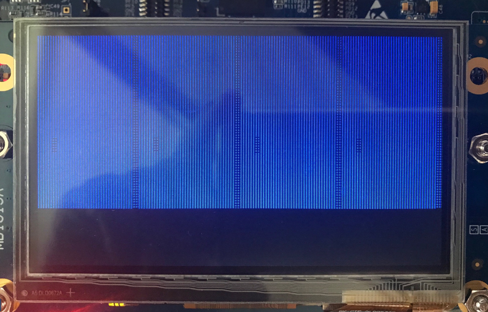

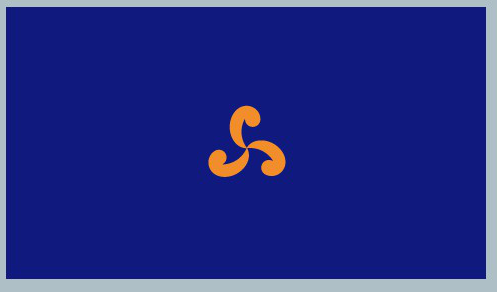

2019-06-10 11:31 PM
Hi Martin,
I try to build a TouchGFX L4+ project by generating a F4 project first and then replace the low level drivers. However, it can not display image correctly.
It should display this
but actually displayed like this . The project file ( for L4R9 EVAL board ) is uploaded. Could you please help to check what the problem is ? Thanks.
2019-06-11 1:54 AM
I don't have an L4R9-EVAL board with the 480x272 display in the lab currently. Maybe you can help me out a bit with some more information:
Have you tried debugging a bit? Is the application working but just displaying things incorrectly?
/Martin
