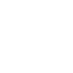

Here is a screen shot from the Designer. The TextArea widgets is inside the big circle widget. The "t:0" TextArea in the upper left corner shows the current frame number.
I have lowered the framerate on my simulator to 1Hz. Do this by adding one line to simulator/main.cpp (after the call to setupSimulator):
static_cast<HALSDL2&>(hal).setVsyncInterval(1000);
I have implemented a handleTickEvent method in my screen to do some invalidation:
void Screen1View::handleTickEvent()
  //press F2 to show invalidated areas
  tickCount++;
  Unicode::itoa(tickCount % 100, textAreaTickBuffer, TEXTAREATICK_SIZE, 10);
  textAreaTick.invalidate();
  switch(tickCount)
  case 5:
    circle.updateArcStart(94);
    break;
  case 10:
    textArea.setColor(touchgfx::Color::getColorFrom24BitRGB(0xF7, 0xC0, 0xC0));
    textArea.invalidate();
    break;
  case 15:
    circle.updateArcStart(98);
    circle.updateArcEnd(314);
    break;
I also use F2 to get the invalidated areas highlighted.

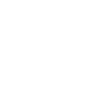

The first frame looks like this (the whole frame is invalidated):
0690X000009ZcO9QAK.bmp The second frame looks the same:
The reason for this second full update is that I am using double buffering. The whole updates done on the previous framebuffer must be applied on the second buffer also.

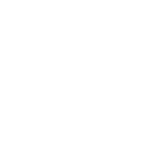

In frame 5, we update the start angle on the circle. Again we get updates in two frames:
Only the little piece of the circle was redrawn.

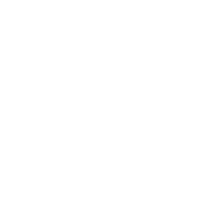

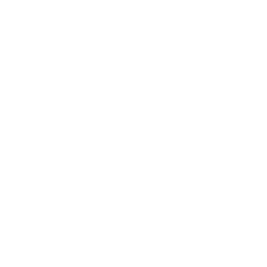

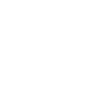

In frame 10 I change the color of the TextArea and invalidate that:

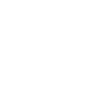

In frame 15 I change both the start angle and the end angle of the circle:
The TextArea is not invalidated here.
If you have seen that invalidating the Circle also redraws the TextArea, it could be because of double buffering, that requires the framework to repeat a change in the first buffer also in the next buffer.

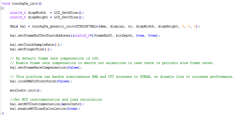

Flemming,
Thanks for your reply. I am using the STM32H750-Discovery kit and have not changed any of the configuration. From what I see in the file BoardConfiguration.cpp, it is set up for double buffering:

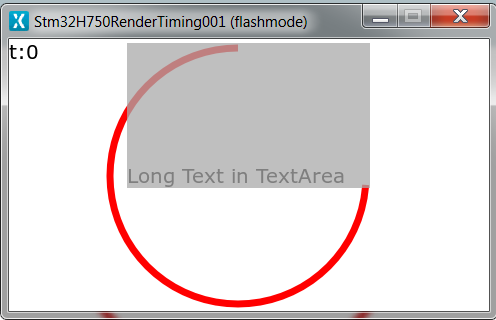

However, I do not think this is the issue. I made a project like yours (including changing the Vsync interval on the simulator). It appeared to work like yours until I did one thing. I commented out the invalidation of the textAreaTick because mine will not have this:
When I did this, I was seeing the same thing that I was with my project (tickCount not being invalidated):

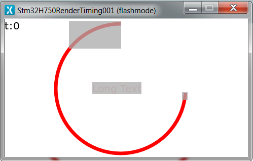

I understand that if it's a big block and overlaps, it needs to redraw all of it. This is the reason I am alternating the invalidation of the different items. The issue I am seeing is that they are invalidating at the same time when they should be alternating. The code is the same exact as yours as I copy/pasted your handleTickEvent() into my Screen1View.cpp file. The rendering alternates as expected. However, If I comment out the invalidation of the textAreaTick, it does NOT alternate but happens at the same time.
I reduced the size of the inside text area to ensure there are no overlaps and ran it again (with the invalidation of the textAreaTick commented out) and as you can see, they are happening at the same time (even with no overlaps):

Yes, if you do not invalidate the TickTextArea in every tick, then you get the TextArea and Circle redrawn in the same frame. This is due to double buffering.
In frame 10 we invalidate the textArea. This causes the textArea to be redrawn in the current framebuffer (call it FB_A).
In frame 11, 12, 13, and 14, nothing is invalidated, so TouchGFX does not draw anything.
In frame 15 we invalidate the circle in both ends. This causes the circle ends to be redrawn in the current framebuffer (FB_B). Since the textArea is not correct in FB_B (was updated in FB_A), it is also redrawn in frame 15.
