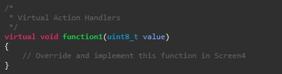

The setLevel function is generated by the TouchGFX designer -
- as a Screen4ViewBase function, and that forwards the inputted value to function1(), which is a virtual void by default within the Screen4ViewBase class -

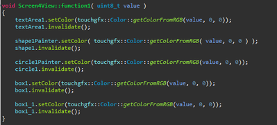

I have overridden that within the user Screen4View class (not the base class) and populated it with what I think is the correct code to change the colors of all the shapes -
I believe my issue (and misunderstanding) is how I am calling the setLevel function from my application code -
- I am able to step through the code and see that the above function does eventually make it to the Screen4View::function1 and run through it properly, but I am not seeing the graphics engine force a re-draw of the invalidated areas. I believe this is because I've instantiated a new instance of the Screen4View that is not tied to the current screen that is being displayed, and so the graphics engine doesn't do anything with my updates.
