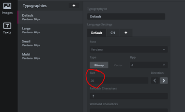

2024-02-22 4:21 AM
Hi @LouisB ,
Thanks for the GeneratedFont reference.
Do you think, that some of these font properties (or at least font height based on user selected size) could be shown in Gfx Designer dynamically, before running font code generator ?
Reason I am asking is realisation that, even though I set the same 'Text:Typography:font size' for 2 fonts (which sets font's baseline), the font heights differ - font_1.getHeight () is 25px and font_2.getHeight () is 26px.
font_1; size(or baseline) 20px, height 25px
touchgfx::GeneratedFont& getFont_verdana_20_4bpp()
static touchgfx::GeneratedFont verdana_20_4bpp
glyphs_verdana_20_4bpp, * @param glyphs
512, * @param numGlyphs
25, * @param height
20, * @param baseline
0, * @param pixAboveTop
return verdana_20_4bpp;
font_2; size(or baseline) 20px, height 26px
touchgfx::GeneratedFont& getFont_NotoSC_20_4bpp()
static touchgfx::GeneratedFont NotoSC_20_4bpp
glyphs_NotoSC_20_4bpp, * @param glyphs
375, * @param numGlyphs
26, * @param height
2, * @param pixAboveTop
return NotoSC_20_4bpp;

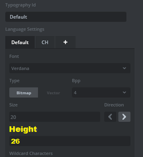

Therefore, the font's height would be a valuable information while setting font size/baseline. Before running font code generator and having to check laboriously resulting "touchgfx/generated/fonts/src/Table_<typography>.cpp". Something like this:
What do you think ?
