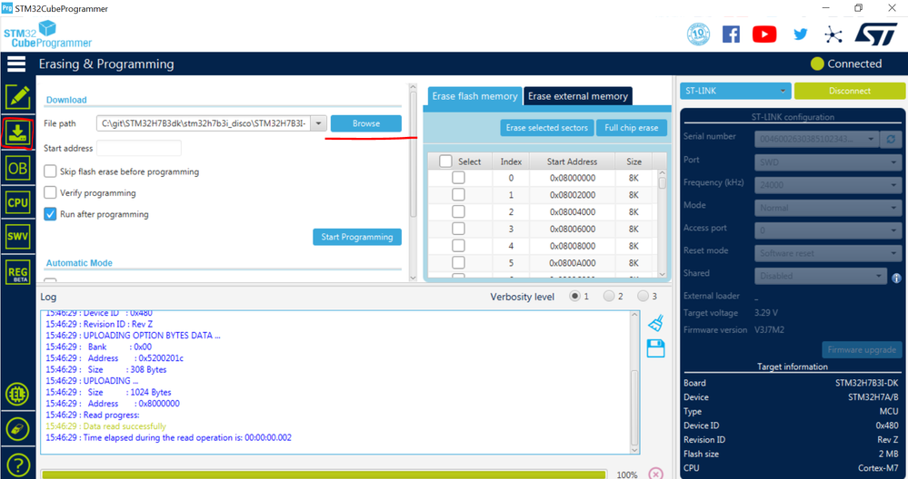

Working with Keil will generate a binary that can be flashed on target using STM32CubeProgrammer or ST link Utility. With TouchGFX Designer and with STM32CubeIDE the STM32CubeProgrammer tool is directly used.
In your case after building your project with Keil you will need to open STM32CubeProgrammer. In the picture below I pointed out how to browse to your project folder and select the generated binary. The .hex file "should" be located at <project_root_folder>/MDK-ARM/<STM32_evaluation_kit_name>/<STM32_evaluation_kit_name>.hex

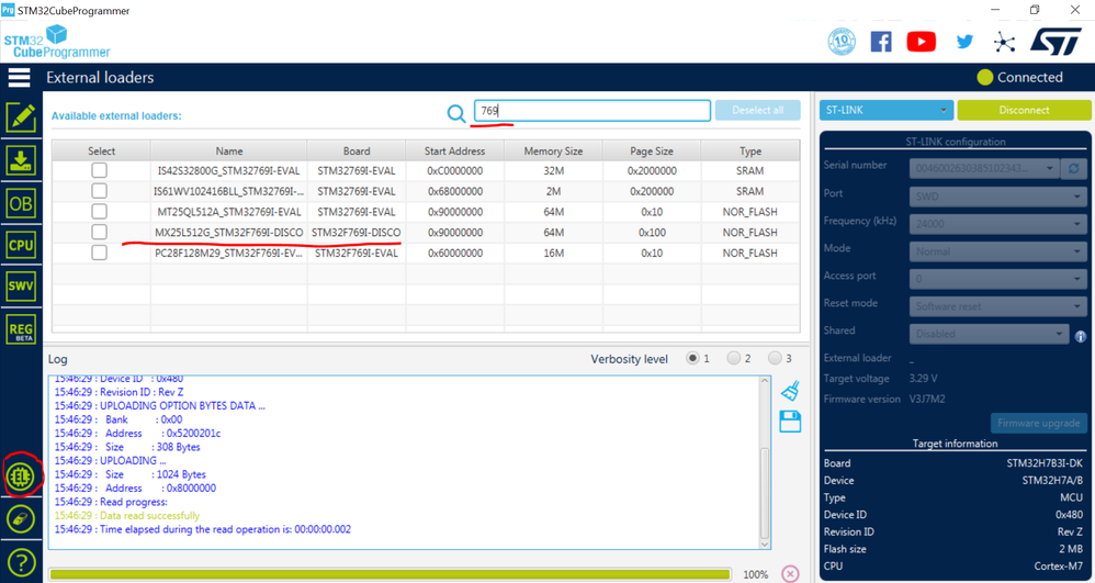

In order to flash on target you will also need to select the correct external loader.
