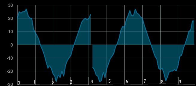

What I want is like this; X-axis label is fixed 0 - 9s ( I draw manually the X-axis by hand, not generated by touchgfx)

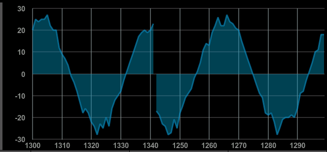

But what Touchgfx gives me is this:
0693W000008ypgaQAA.pngAs we can see from above, X axis label show data point instead of time in seconds and the label grows instead of fixed.

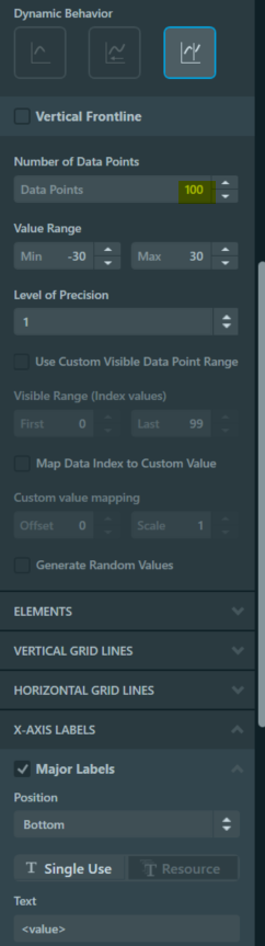

Setting:
0693W000008yphcQAA.pngMy development board is:
