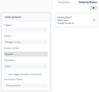

To save flash memory, TouchGFX generates only the screen transitions that are actually used.
If you only need the transition function in your code and do not already have an existing interaction for it, you can create an empty interaction that changes screen, as shown below.
Then, the function gotoScreen1ScreenNoTransition() will be generated.
