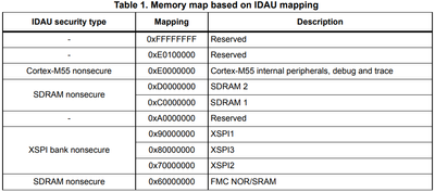

You know, my main concern is where I can allocate the bitmap cache. Because there is no SDRAM on the N6-DK board.

I tried, but it failed. I set the start address as 0x34000000, the touchgfx can actually run, but it just cannot show the dynamic bitmap. And if I set a new screen to display this bitmap, I cannot skip to the bitmap screen, but I can show the main screen and the starting one.

Hello @Z-YF ,
It seems that the chip can indeed have SDRAM at 0xC000 0000 but the DK board itself doesn't have SDRAM connected at that address.
Instead, you should use the PSRAM on XPSI1 located at 0x9000 0000.
Regards,
