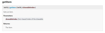

Indeed, in the documentation, on the API class of ScrollList (documentation_scroll_list), you can see that the get item method uses an int16 which is the limit of items you can create:
However, your MCU might probably not have enough memory to store 4000 custom containers containing each multiple widgets.
