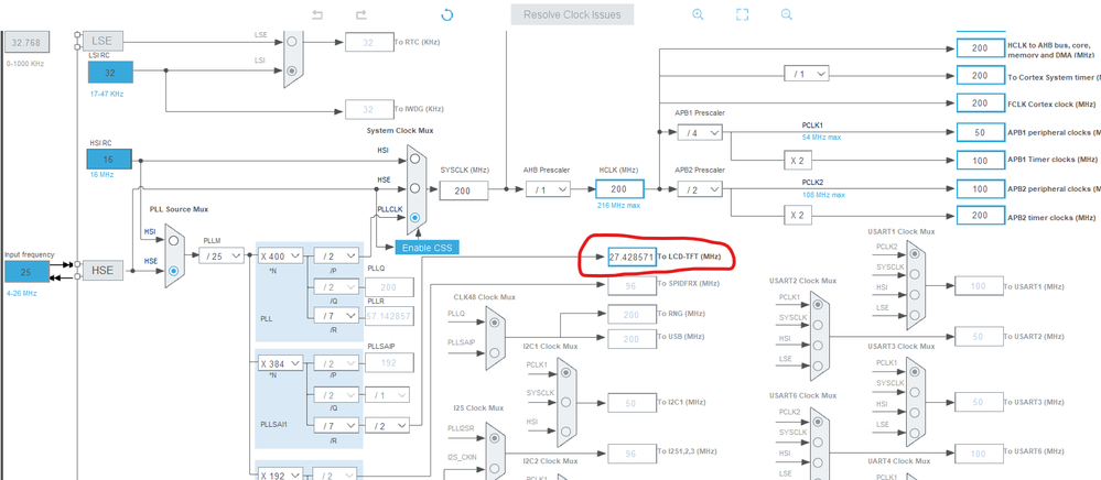

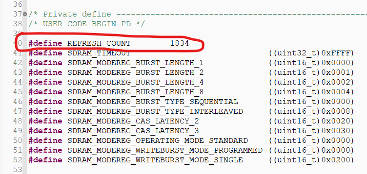

What is the clock rate to be set for LCD-TFT(MHz) and what does the value 1834 indicate? How do we calculate them?
2022-07-13 12:25 PM
Marked refresh count is partof SDRAM config ...
LCD dot clock is based on your LCD pdf plus framerate you use as optimal .
Normal calc is (WIDTH + sync porch ..) x ( HEIGTH + sync porch) x FPS = DCLK
