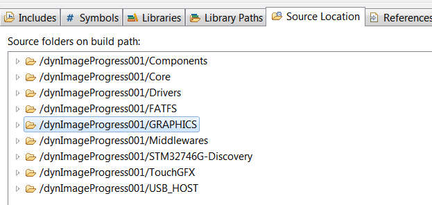

I do see it there in the Compiler Settings:
Deleting it from there did, in fact, remove the warning as you said it would.

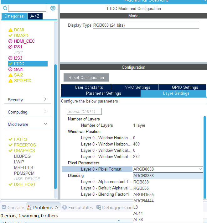

I am currently trying to figure out the BPP on this project and was setting the Pixel Parameters for the LTDC (in CubeMX perspective).
Changing that apparently caused it to reference GRAPHICS and reintroduced the warning again. I can easily delete it from the compiler settings, but I wanted to let you know how I recreated it.

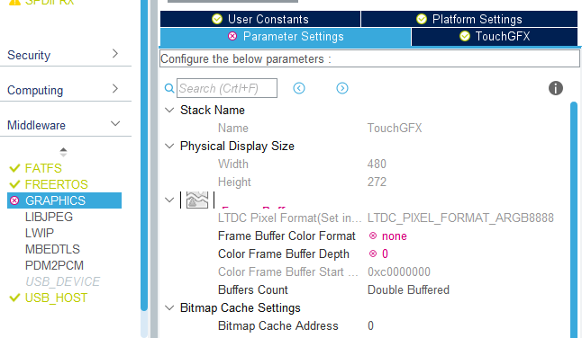

Regardless, when I selected ARGB8888 , the TouchGFX Frame Buffer Color Format and Color Frame Buffer Depth settings didn't like it (red in screen capture below):
Maybe I am not correctly setting this up? Is this the place to do this so that I correctly use ARGB8888 for dynamic bmps?

I have a similar situation for the "RTOS2" folder
The entry with the RTOS folder can be found in the .cproject file. CubeMx is responsible for this.
Simply adding the missing folder from the file manager solves the problem.
Additionally, this folder can be deleted from the file project tree in STM32CubeIDE, which will remove the folder from the file system and from the .cproject file to...
