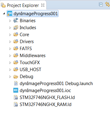

I created a new project in STM32CubeIDE 1.1.0 , and followed the steps to create a simple design in the TouchGFX designer.
It is a simple project with an imageProgress widget in it. Below is what the Project Explorer shows (yes, I did Right Click > Refresh):
Below is the warning:
Should there be a GRAPHICS folder in the project?

Can you try to inspect the .cproject file or .project file for where this reference is coming from and paste it here? It looks strange.
/Martin

GRAPHICS does not appear in the .project file.
It appears in the .cproject file in two places:
Here is one place (under storageModule moduleId="cdtBuildSystem"):
<option id="com.st.stm32cube.ide.mcu.gnu.managedbuild.option.defaults.1796982624" name="Defaults" superClass="com.st.stm32cube.ide.mcu.gnu.managedbuild.option.defaults" value="com.st.stm32cube.ide.common.services.build.inputs.revA.1.0.3 || Release || false || Executable || com.st.stm32cube.ide.mcu.gnu.managedbuild.toolchain.base.gnu-tools-for-stm32 || STM32F746G-DISCO || 0 || 0 || arm-none-eabi- || ${gnu_tools_for_stm32_compiler_path} || ../USB_HOST/App | ../FATFS/App | ../Middlewares/Third_Party/FreeRTOS/Source/include | ../TouchGFX/gui/include | ../TouchGFX/generated/fonts/include | ../Drivers/CMSIS/Device/ST/STM32F7xx/Include | ../TouchGFX/generated/texts/include | ../Drivers/STM32F7xx_HAL_Driver/Inc | ../TouchGFX/generated/images/include | ../Middlewares/ST/STM32_USB_Host_Library/Core/Inc | ../Middlewares/ST/STM32_USB_Host_Library/Class/CDC/Inc | ../Drivers/CMSIS/Include | ../Core/Inc | ../Middlewares/ST/TouchGFX/touchgfx/framework/include | ../TouchGFX/generated/gui_generated/include | ../Middlewares/Third_Party/FreeRTOS/Source/portable/GCC/ARM_CM7/r0p1 | ../FATFS/Target | ../USB_HOST/Target | ../Middlewares/Third_Party/FreeRTOS/Source/CMSIS_RTOS | ../Drivers/STM32F7xx_HAL_Driver/Inc/Legacy | ../Middlewares/Third_Party/FatFs/src | ../TouchGFX/target ||  ||  || USE_HAL_DRIVER | STM32F746xx ||  || Drivers | USB_HOST | TouchGFX | Core/Startup | GRAPHICS | Middlewares | Core | FATFS ||  || ../Middlewares/ST/TouchGFX/touchgfx/lib/core/cortex_m7/gcc/libtouchgfx-float-abi-hard.a || ${workspace_loc:/${ProjName}/STM32F746NGHX_FLASH.ld} || true || NonSecure ||  || secure_nsclib.o || " valueType="string"/>
Here is the other (which is under "sourceEntries"):
<sourceEntries>
						<entry flags="VALUE_WORKSPACE_PATH|RESOLVED" kind="sourcePath" name="GRAPHICS"/>
						<entry excluding="ST/TouchGFX/touchgfx/framework/source/platform/hal/simulator/sdl2/HALSDL2.cpp|ST/TouchGFX/touchgfx/framework/source/platform/hal/simulator/sdl2/HALSDL2_icon.cpp|ST/TouchGFX/touchgfx/framework/source/platform/hal/simulator/sdl2/OSWrappers.cpp|ST/TouchGFX/touchgfx/os/OSWrappers_cmsis.cpp|ST/TouchGFX/touchgfx/framework/source/platform/driver/touch/SDL2TouchController.cpp|ST/TouchGFX/touchgfx_backup*" flags="VALUE_WORKSPACE_PATH|RESOLVED" kind="sourcePath" name="Middlewares"/>
						<entry excluding="generated/simulator/src/mainBase.cpp|simulator/main.cpp" flags="VALUE_WORKSPACE_PATH|RESOLVED" kind="sourcePath" name="TouchGFX"/>
						<entry flags="VALUE_WORKSPACE_PATH|RESOLVED" kind="sourcePath" name="USB_HOST"/>
						<entry flags="VALUE_WORKSPACE_PATH|RESOLVED" kind="sourcePath" name="Core"/>
						<entry flags="VALUE_WORKSPACE_PATH|RESOLVED" kind="sourcePath" name="FATFS"/>
						<entry flags="VALUE_WORKSPACE_PATH|RESOLVED" kind="sourcePath" name="Drivers"/>
					</sourceEntries>
No problem, Scott.
What a nice little evening exchange we're having here on multiple threads. This definitely looks like something is broken in the project generation from CubeMX/IDE. Those "entries" refer to source paths as you can obviously tell, but there's no such thing as a "GRAPHICS" folder. Not sure where that comes from - I'll have to verify tomorrow at the office.
You can remove it by going to project settings. There's a list of source entries probably in the compiler settings.
