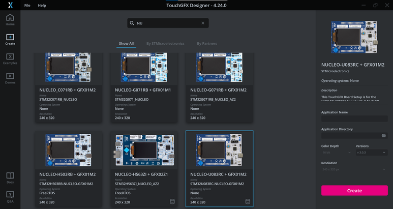

There are plenty of TouchGFX Board Setups (TBS) that use SPI display interface. You can draw inspiration from them for your use case.
TBSs using SPI display interface

I think the warning is because touchgfxSignalVSynch() is not declared. You can declare it in the driver for your display.
