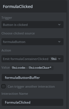

Hello @GaetanGodart I guess my question is that, I am able to send data from the container to the screen using Triggers and interactions on the container. The problem seems to be that I can only send data scoped within the containers base file. Here is an example where I successfully emitted data out, and it worked because the button Buffer is apart of the containers base file. When I try to send data which exists outside of the generated base file, it does not work. When I build it, I get an error in the base.cpp saying the variable was not declared in this scope

Hello @Priyank ,
Yes, this is normal.
If you want to understand more how it works, create a new action, trigger and interaction and go look at base file for the custom container. You will see that the above mentioned element have been created and the function has a parameter of the specific type mentioned.
Because using an action, trigger and function basically just calls a function, you need to know the type in advance to generate the correct function in the base file.
So basically, the error you can read is correct : you need to declare the variable you want to use.
