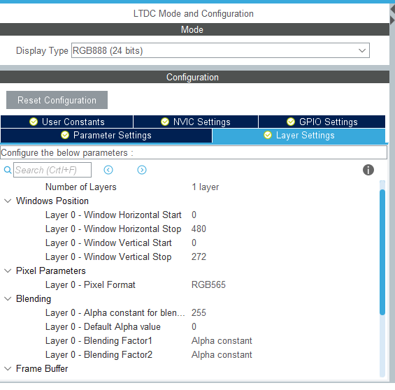

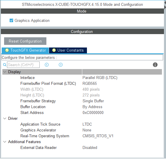

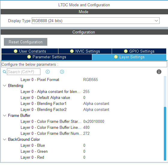

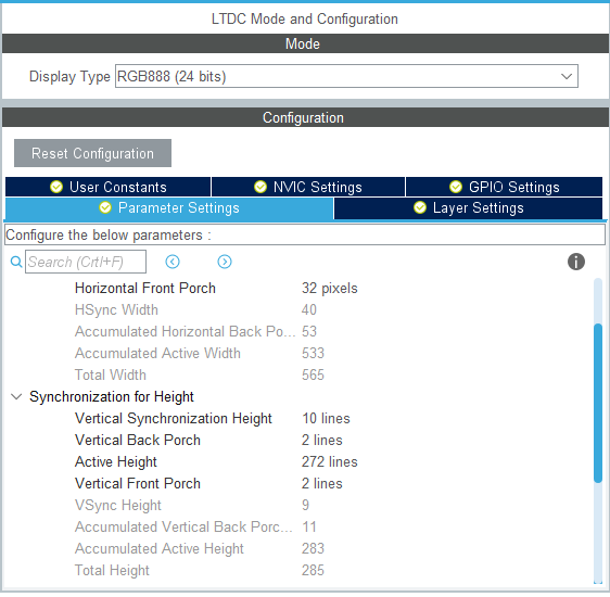

the .ioc cubeMX file is attached,
Im using f7 discovery witch uses 480*272 LCD so I need 480*272*16bit/8 = 261120 bytes space and stm32f746NG has got 320kbytes of internal RAM space, configuration is set on 1 framebuffer and the test gui is a simple background so i thaught it wont cause any problem to use this method but all i get is a black screen.
I'm e beginner maybe Im mistaken in storage calculation and I'm not considering something.
the cubeMx configuration screenshots are:
2020-11-18 6:31 AM
Out of curiosity, why do you put the start address at 0xC0000000 in the last screenshot? When I opened the ioc project you shared, it automatically sets it to 0x20020000. The configuration overall seems ok at first glance, I compared it to the F746G disco AT and the H7b3 disco AT we provide in Designer. The only thing that surprises me yeah is that you set the color frame buffer start address at 0x20010000 and then the start address for the "touchgfx" framebuffer at 0xc0000000
Could you test it real quick if that makes sense?
2020-11-18 6:34 AM
In a normal STM32F746G disco board it is the SDRAM configured in FMC that is mapped at 0xC000000 . Are you using a custom hardware or you just modified the generated AT for the F746G disco?

sorry I gave you the old one, in the last configuration I set the address to 0x20000000 but the compiler said that framebuffer there is about 7016 bytes out of range, then i checked the documentation of the mcu and found out somthing about 250 kbytes of internal RAM is accessible so I think theres no way I can procced this way, the only thing that surprises me is the thing I read in touchgfx webpage witch said that it is possible to run a 480x272 TFT with internal RAM of this MCU
