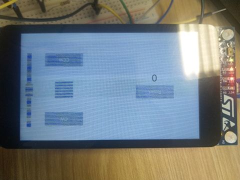

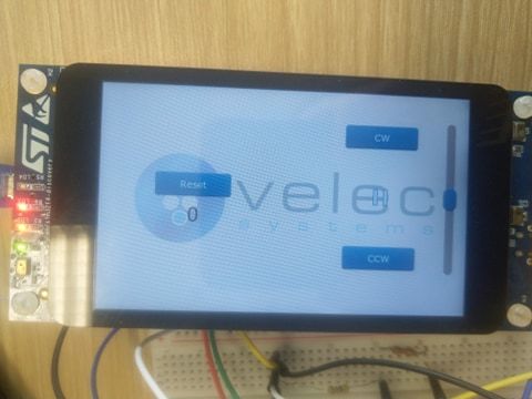

I successfully created a user interface on an STM32F469I-DISCO which looks rather neat.
However, with only a few icons it uses, the memory is already about 80% full. That's why I tried to use the embedded SDRAM to store the data required for the layout. I added the SDRAM to the linker file using the following :
SDRAM (xrw) : ORIGIN = 0xC0000000, LENGTH = 16MThe embedded SDRAM is supposed to be 128Mbit but I test with only 16Mbit.
However, when I place the ExtFlashSection for TouchGFX inside the SDRAM with
ExtFlashSection :
*(ExtFlashSection ExtFlashSection.*)
*(.gnu.linkonce.r.*)
. = ALIGN(0x4);
} >SDRAM
BmpCacheSection (NOLOAD) : { *(BmpCacheSection) } >SDRAM
TouchGFX_Framebuffer (NOLOAD) : { *(TouchGFX_Framebuffer) } >SDRAM
TouchGFX_Framebuffer1 (NOLOAD) : { *(TouchGFX_Framebuffer1) } >SDRAM
TouchGFX_Framebuffer2 (NOLOAD) : { *(TouchGFX_Framebuffer2) } >SDRAMthe display shows crap.
I attached two pictures, one which shows how the screen is supposed to look and one showing the display after placing stuff inside the SDRAM. Did anyone encounter this issue before? When yes, what had been done?

2021-02-02 1:20 PM
Your idea is fail. And too your lines 8-11 is for me puzzle.
Primary you need learn how memory is for what usable. Extflash section in TouchGFX design is for graphics const data, when you redefine in to SDRAM ,after reset data not exist, need preload from FLASH then you have same data on two places...
Second miss must be your config, because 2M FLASH can store perfect amount of graphics in 24bit colorspace. When you need more use L8 formats for store images.
