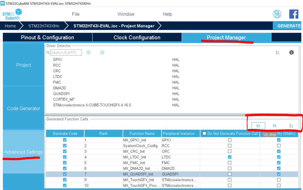

2021-01-20 6:12 AM
Thank you for reporting this. I am surprised by it as well as I could replicate the issue on projects on a STM32H743 eval board and on a H7b3 dk board. It seems that only the MX_TouchGFX_Init is not working, we will investigate more on that (might be just me not aware of a step to do). Could you add the topic "CubeMX" in the Topic tags of this post ? That way this will have more visibility.
Are you working on a custom board ? Did you start your project from scratch from CubeMX ? I am asking this because from what I understand from your message, you have the MX_TouchGFX_Init called before the MX_QUADSPI_Init ? This is not the case in the application template for the H743 eval board available on TouchGFX Designer. I believe the issue might come in your case from the "rank order" of your functions: you can see that in the Project Manager tab -> Advanced Settings --> Generated Function Calls. You can change the ranks of the function by selecting a function and pressing the "up or low arrows" on the top right (see picture)
/Romain
