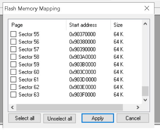

I just checked the source code of the external loader and you are fully right, it contained 64 sectors instead of 128 in the description.
This was not noticed since the demo had enough room for its assets.
Please find attached a corrected version of the external loader, just unzip it in the following folder :

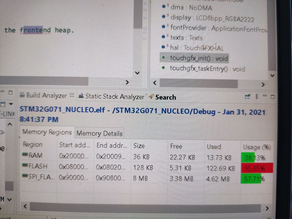

if the compiled extflash.bin is over a certain size (typically over 4MB) the external flash loader provided by ST for this demo board (GFX01M1 + STM32G071 Nucleo board ) fails to load this file to external flash .
Actually i tried several times using different boards and it always fails at verification step @ address 0x90400000, according to linker script this is in ext flash area and it correspond to a size of 4,194,304 byte which should still fit in that flash chip used (MX25L6433FM2I-08G 64-Mbit SPI NOR Flash ) so there is plenty of space left ...
 i tried different ALIGN options in linker script for ExtFlashSection & FontFlashSection : 2 , 4 , 8 , 16 , 32 but no effect is observed . for some raison the flashing process of external memory always fails @ 0x90400000 this is quit frustrating.
ps : i'm using GFX01M1 + STM32G071 Nucleo so all BSP drivers are provided by st (lcd , ext flash , buttons ....)

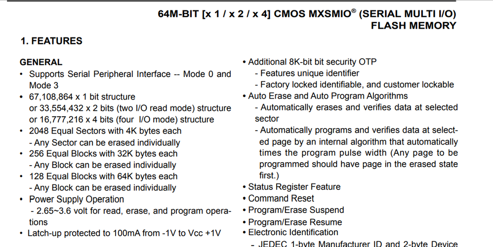

I'm using MX25L6433F_STM32G071B_NUCLEO.stldr which is the appropriate flash loader for this demo board , it's not about .bin or .hex it's a bug in the flash loader itself and since we don't have access to source code this require someone from ST to intervein which i would highly appreciate since this post has over 2 days !!!.
BTW : compiled extflash.bin is around 4.8MB so its not an overflow problem .

when using STlink utility allong with the appropriate flash loader , when it come to sectors erase it only shows 64 sectors of 64KB each or this is just half of NOR chip capacity (8MB) , datasheet says it has 128 sectors of 64kB each , hmmm i guess that the flash loader is bugged0693W000007DfuYQAS.png0693W000007DfuJQAS.png
ANY suggestions STM team ???

You can build own loader examples c:\Program Files (x86)\STMicroelectronics\STM32 ST-LINK Utility\ST-LINK Utility\ExternalLoader\
