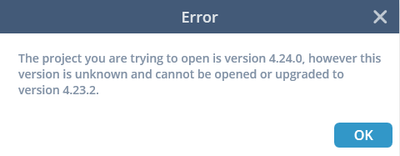

Hello @Mohammad MORADI ESFAHANIASL ,
I have trouble opening the project i get an error (see attached image). Any tips on how to get it working?
2024-07-31 4:33 AM
Is it possible for you to use or switch to TouchGFX 4.24.0?

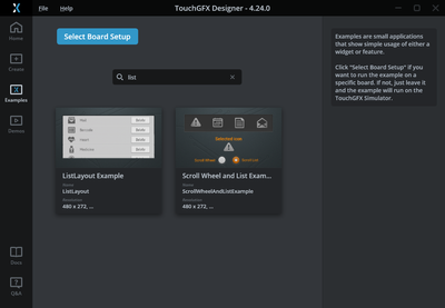

Hello Bjorn
I suggest you to try listLayout and ScrollList examples first
And also read the documentation of those
https://support.touchgfx.com/docs/development/ui-development/ui-components/containers/list-layout
https://support.touchgfx.com/docs/development/ui-development/ui-components/containers/scroll-list
I think based on these you will be able to build system you need.
Br JTP
