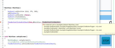

I checked a way which was suggested by @JTP1 in the morning and i have a problem - I can't add a callback to the constructor:
Do you have a idea where is a problem?

2024-07-31 9:52 AM
// Try like this:
MainView::MainView():
flexButtonClickedCallback(this,&MainView::flexButtonClickHandler)
keyboard.setPosition (0,0, 379, 320);
add(keyboard);
keyboard.setVisible (false);
keyboard.invalidate(); //gaugel.setValue(bigos),
}If not work, can you show mainView.hpp and flexButtonClickHandler function from mainView.cpp
Br JTP

@JTP1 yours advice with callback is good and I can compile project.
Outputs are turn on/turn off but they are switched all the time when I hold the flexButton - the same effect I had at the beginings, when I wrote here.

void MainView::flexButtonClickHandler(const touchgfx::TextButtonStyle< touchgfx::ImageButtonStyle< touchgfx::ClickButtonTrigger > > & b,const ClickEvent& e)
if(&b==&flexButtonCofnij) // button1 -> your button name
if (e.getType() == ClickEvent::PRESSED)
//touchgfx_printf("Button is pressed..\n");
presenter->setPin();
else if (e.getType() == ClickEvent::RELEASED)
//touchgfx_printf("Button is released..\n");
presenter->resetPin();

Can you help me to find a faulty in my code?
2024-07-31 12:28 PM
Hello. In this case i would check the touch panel handling/reading, is the sampleTouch-function getting steady and consistant coordinates every time it is called.
Br JTP
