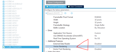

Not sure if I remember I had the same error, isn't it related to enabling it in MX ?
