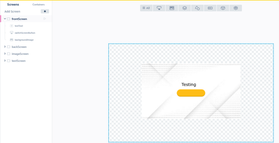

2025-01-29 10:22 PM - edited 2025-01-29 10:25 PM
Hello @MM..1
I added the new text testText in the project and then did this testing.
By default, I set it to hidden in touchGFX designer and performed the testing.
