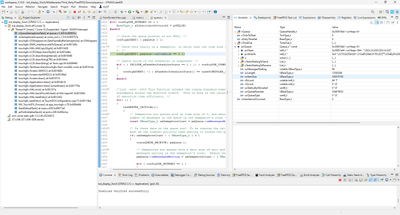

2025-01-26 11:50 PM
The reason it can show a string of spaces, is because there are no pixels in a space.
This points to a problem with reading flash.
But then, if it also fails with texts and flash in internal flash, then something else is wrong.
When it hangs there, someone did not return the framebuffer semaphore.
Any custom widgets? Other code calling lockframebuffer?
Did you remember to call the superclass in TouchGFXHAL::endFrame? (if you modified it).

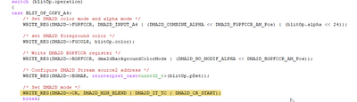

If you remove the A4 line, all texts are drawn in SW, not DMA2D. Does it make a difference?
In the same file, using a debugger, set a breakpoint on this yellow line:
What does the ISR register of DMA2D say? Any errors?
Also check that the FGMAR (font) and BGMAR (framebuffer) addresses are both readable.
Verify the addresses in the MAP file.

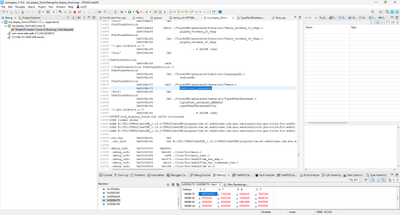

The breakpoint is never hit in the debugger.
The system enters the function but does not enter the mentioned case. It either enters in default case ( BLIT_OP_COPY & BLIT_OP_COPY_16BIT ) or BLIT_OP_COPY_ARGB8888_WITH_ALPHA case.

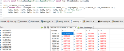

Also I have checked the memory where the text is stored and verified it to be correct.
In map file following are the addresses where the generated text are stored in external flash
TextFlashSection
0x9009b168 0x34
*(TextFlashSection TextFlashSection.*)
TextFlashSection
0x9009b168 0x8 ./TouchGFX/generated/texts/src/LanguageGb.o
0x9009b168 indicesGb
TextFlashSection
0x9009b170 0x22 ./TouchGFX/generated/texts/src/Texts.o
0x9009b170 texts_all_languages
*fill* 0x9009b192 0x2
TextFlashSection
0x9009b194 0x8 ./TouchGFX/generated/texts/src/TypedTextDatabase.o
0x9009b194 typedText_database_DEFAULT
0x9009b198 typedTextDatabaseArray
*(.gnu.linkonce.r.*)
0x9009b19c . = ALIGN (0x4)TEXT_LOCATION_FLASH_PRAGMA
KEEP extern const touchgfx::Unicode::UnicodeChar texts_all_languages[] TEXT_LOCATION_FLASH_ATTRIBUTE = {
0x4e, 0x65, 0x77, 0x20, 0x54, 0x65, 0x78, 0x74, 0x0, // @0 "New Text"
0x54, 0x65, 0x73, 0x74, 0x69, 0x6e, 0x67, 0x0 // @9 "Testing"
From the memory reader we are able to read the exact text stored at the address mentioned in the map file.

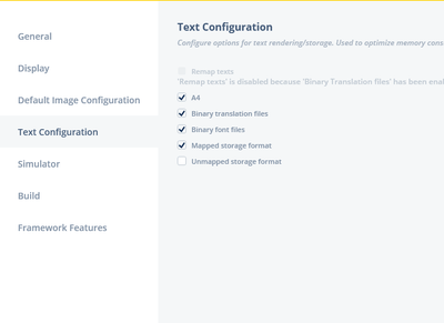

Also if I change the text configuration to following:-
That is enable binary font file and disable remap texts then the Text is not displayed even when set to Visible but the task continues without getting stuck.
