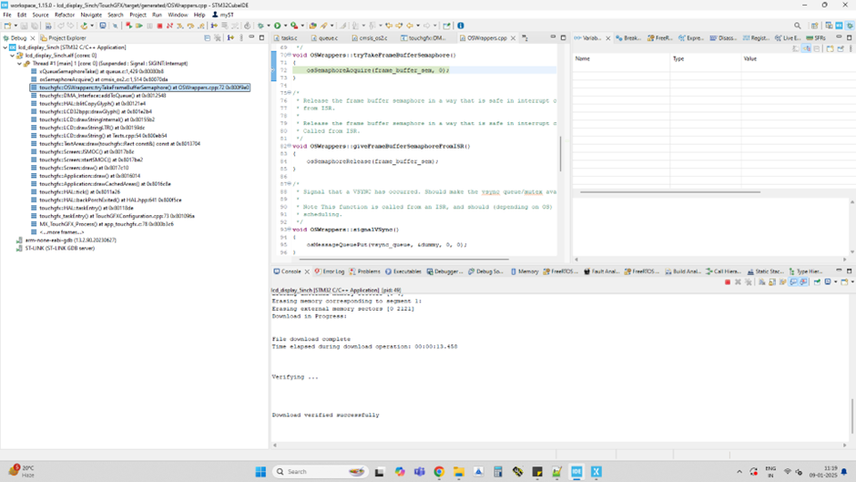

Earlier we have successfully developed a variant using STM32F746 Discovery board but now we have shifted towards our own developed PCB with custom LCD Display 800 * 480.
Our new PCB uses MT25Q128A external flash for storing images, text and font used by TouchGFX and we are using single buffer allocation in external SDRAM for framebuffer. We are using different pins for QuadSPI communication so had to develop custom external loader for this. We have tested the external loader for various images and it works fine.
When we started inputting texts in TouchGFX the system would wait infinitely in xQueueSemaphoreTake() function so we suspected something might be wrong with loading from external flash so we created another project this time stored everything in internal flash, again the result was same, the TouchGFX hangs while using texts.

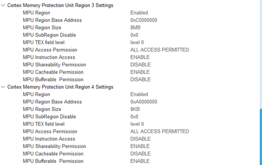

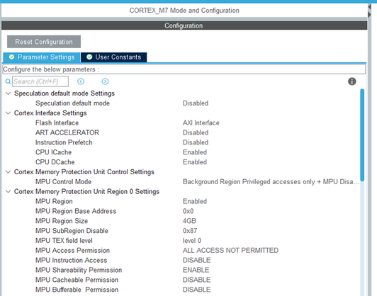

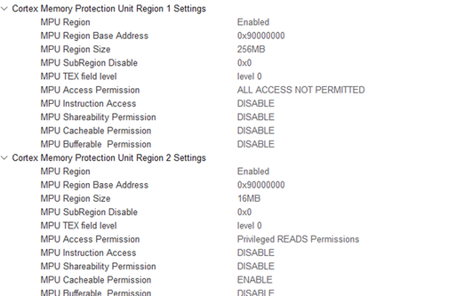

2025-01-25 1:31 AM - edited 2025-01-25 1:39 AM
Hello @MM..1
Sorry for the inconvenience caused.
TouchGFX Version : 4.22.0
STM32CubeIDE Version : 1.15.1
STM32CubeMX Version : 6.11.1
I am currently using the same version with stm32f746 Discovery Board and do not face any issue.
But using texts in this custom setup causes touchGFX to hang.
Following are MPU Settings :-
Thankyou
Regards,
Pitbull

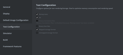

2025-01-25 1:59 AM
Hii @Flemming Gram CHRISTENSEN @MM..1
Another finding is that if I keep the text visible but the value in the text is set to white spaces " " then the touchGFX does not hang and continues working as expected.
But even if we add a single character, number or symbol in the text then the touchGFX hangs and gets stuck.
So as @MM..1 is suggesting there might be issue with Fonts but I am unable to track it down.
Following is the text configuration in touchGFX :-
Thankyou
Regards,
Pitbull
