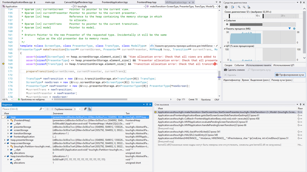

I encountered a memory allocation error (Transition allocation error) for animating transitions between screens while debugging GUI in Visual Studio 16.8.6.
Assert check tells me that all transitions should be registered in FrontendHeapBase.hpp / FrontendHeap.hpp files.
Since I don't use my own transitions and work with animations using TouchGFX Designer 4.16.1, all transitions are already registered in the FrontendHeapBase.hpp file (I use only one animation):

virtual void gotoStartScreen(FrontendApplication& app)
app.gotoStartScreenScreenNoTransition();
}Accordingly, no other transitions have been added to the FrontendHeap.hpp file:

> > CombinedViewTypes;Nevertheless, this error started appearing when calling a transition on one of the screens. On other screens, transitions work fine. I increased the CANVAS BUFFER manually on that screen from 15360 to 20000 and for a while the transitions worked fine until I added a couple more buttons. I tried increasing the CANVAS BUFFER to a maximum of 32767, but the error continues to occur. When I start memory usage monitor on the screen it shows me that actually only 2500 bytes are used.
Please could you advise me possible solutions?
