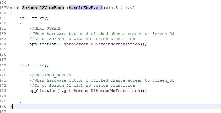

2023-08-05 2:26 PM
Hi ...

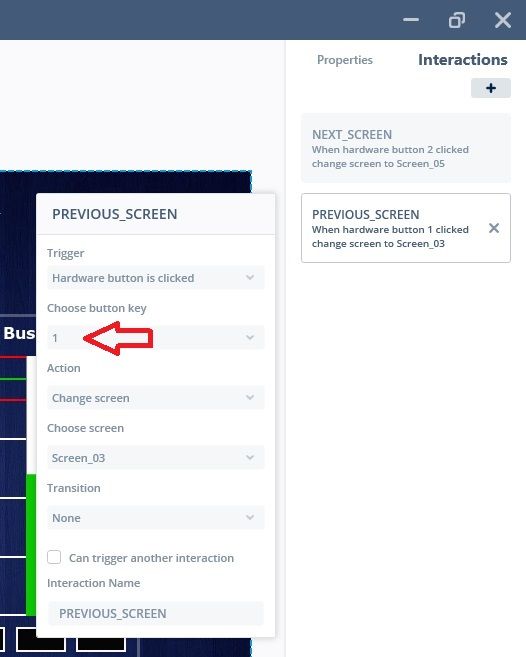

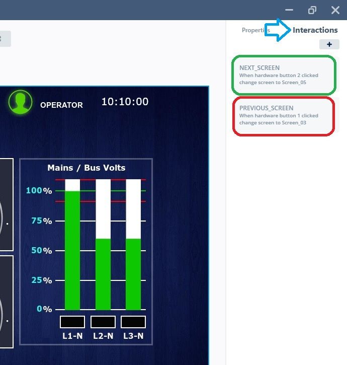

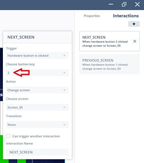

For screen changing in sequence or jumping to any screen , Interaction feature is used.
I use 2 Interactions for each screen (accept first and last screens) as NEXT_SCREEN & PREVIOUS_SCREEN
For NEXT_SCREEN Interaction , below is example
For PREVIOUS_SCREEN Interaction , below is example
Tip: To keep the codes uniforms for each screen transition , name the screens like ,
Screen_01 , Screen_02 , Screen_03 etc
for each ScreenViewBase.cpp , the transition will be added like below

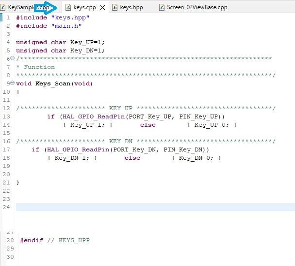

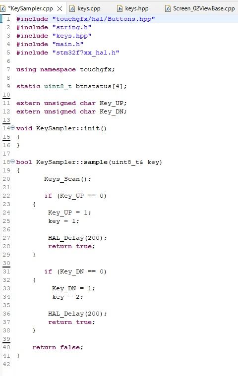

Now , need to code the keys read feature any one of followings

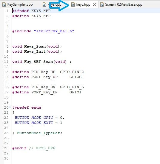

1. Simple GPIO keys without interrupt
2. SPI IO Expander Keys with interrupt
3. I2C IO Expander Keys with interrupt
I will show you 1 example > Simple GPIO keys without interrupt
keys.hpp
keys.cpp

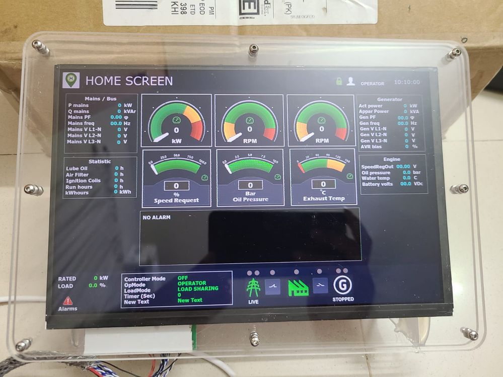

Following is one of my ongoing TouchGFX development with Samsung Tab3 10.1" , 1280x800 TFT
In this experiment , I have 10 different screens .
attached are the files for first type : Simple GPIO keys without interrupt
Let me know , if more info required.
BR
I.N
