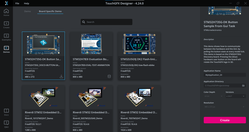

Personally, I have no experience using FDCAN, but what I can suggest is to start slowly and progress little by little. First, ensure you can run your application with only the FDCAN setup, without any communications. Then, try to send or receive specific data, so you can check the communication and verify if the data is transmitted correctly or not.
If you are unsure how to transfer data between you GUI application and hardware, there are Board Specific Demos available in the TouchGFX Designer which you can study to learn the process. I suggest you take a look at STM32H735G-DK example.
STM32H735G-DK Board Specific Demo
In addition, there is documentation that describes the process of handing external event. You can access it from here .
I hope this helps you, don't hesitate to ask more questions

Hello @DylanWalt ,
