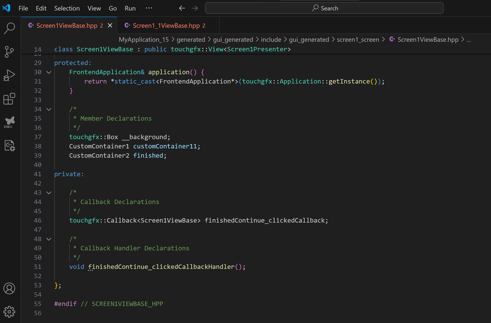

2024-04-16 6:41 AM - edited 2024-04-16 6:52 AM
Thanks for checking, I completely agree with you that those should be separate objects and there should be no link with the designer. However, somehow there seems to be..
Could you check one more time, as I wasn't clear enough about 'No Callback generated'.
What I actually meant is in the Screen1_1ViewBase.cpp the line to register a callback is missing in the constructor.

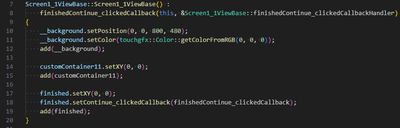

Opened the project in the designer and clicked generate code:

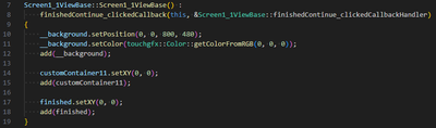

Selected Screen1_1 in the designer and clicked generate code:
After selecting the Screen1_1 you have to re-open the project in the designer to reproduce the bug again.
It fails to generate the register callback until you select the Screen1_1 view.
