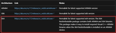

LouisB
Hello @farble1670,
It's fine, can you confirm you download the x64 version ?

Hello @farble1670 , First welcome to the TouchGFX forum !
You have to install the latest version of VC++, TouchGFX designer is dependant of that. Which version have you downloaded ?

I downloaded the VC++ redistributable from here: https://learn.microsoft.com/en-us/cpp/windows/latest-supported-vc-redist?view=msvc-170#visual-studio-2015-2017-2019-and-2022 and installed, per the other forum link. That did not solve the problem. Am I missing something?

You're right, I installed the x86 version. I read "ARM support" and thought "well I don't need that". It's starting up now.
