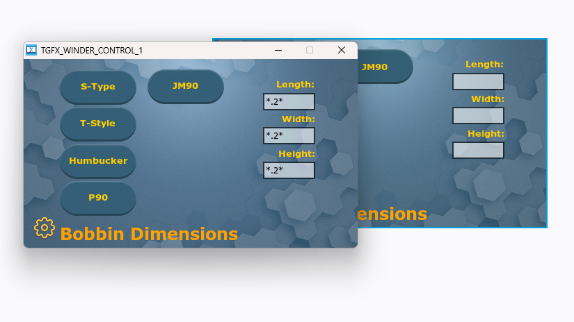

Hi all. I'm trying to display local floating point variable data via a button click in text area fields on my TouchGFX project screen.
I seem to be having an issue. It appears that the fields are being populated with the format specifier that preceeds the variable in my code. Here is my button function:

}Here is the result of the button click (using the asterisk as a fallback character):
I have tried multiple ways to try to correct this behaviour without success. If anyone can shine a light on my errors/issues, I would be exteremely appreciative. Thanks

Use snprintfFloat instead of snprintf
Refer to: https://support.touchgfx.com/docs/api/classes/classtouchgfx_1_1_unicode

Yay! So simple. Thanks for the super quick response! Fixed it.
